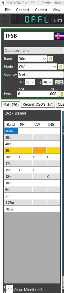

U type in a new call, get good news with a green square indicating that country is confirmed.
How do you quickly find info on that contact?

Go to the Main (F6) tab. In the lower right hand corner of the Log4OM screen, click on the lower of the two symbols (if you hover over it, it says "Show/hide statistics"). If there is a call in the callsign box, the statistics box will show what bands have been worked and/or confirmed for that country. For that matter, you just have to put a prefix in the callsign box, and it will produce the same results. In the example I used, TF5 (or any numeral after the letters) will work.
