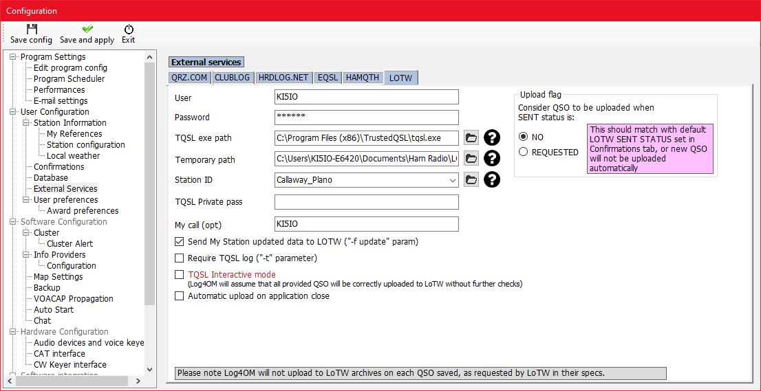

Have you properly set up the "temporary path" for the LOTW/TQSL uploads? Image below shows my configuration.
- LOTW-config.JPG (106.49 KiB) Viewed 1850 times

The temporary folder should NOT be put in the directory area you noted. It is protected.
Rather, put it under your Windows default "Documents" folder. Create a series of folders that make sense for you.

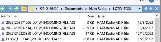

Image below shows my actual path that I have created under the "Documents" folder.
- LOTW-folder-config.JPG (33.36 KiB) Viewed 1793 times
