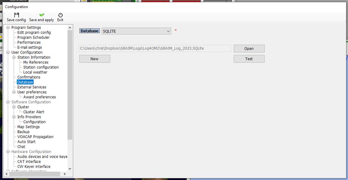

At the end of 2022 I created a new log for 2023. This was so I could see what was “needed” during the new year. This resulted in 2 databases which I’ll call “Alltime.SQLite” and “2023.SQLite”. On occasions I want to open the Alltime log and for some reason I’ve not been able to do that.
In the past when I was using Vers 1 I could swap between databases with ease by simply double clicking on the one I wanted to open, however now no matter what I try (closing one first then trying to open the other, renaming, relocating the file, attempting to open from within the program). Strangely, whatever I try the program always opens the 2023 log. When I try Settings/Config/Database I am only offered the 2023 log although both are in the same folder.

Just file/open(NEW) database
select database
click 'Open'
Save and apply

Thanks Terry but I'm only offered the 2023 file. If I choose "New" I then see both files but by choosing the alltime file I'm asked if I want to replace it.
