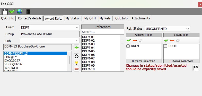

If you open the QSO with TM6J and check the "Awards Refs." tab, can you see the DDFM entry in the left box?
20230723 - DDFM.png (38.09 KiB) Viewed 8973 times
If not, please select DDFM in "Award" and double-click the DDFM-14 entry in the References list )it should appear in the left box). Save the QSO and retry, please. I have not changed this award since the first release of L4O2.

After checking, yes the DDFM ref was shown but noticed it was shown as DDFM@14 instead of DDFM@DDFM-14. It is now ok then.
Probably due to an award update since the QSO was validated I think?
