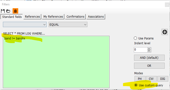

For the Band, make a filter such as:
band filter.png (19.44 KiB) Viewed 821 times
Then sort by Band and Select all QSO with the same Band (10m for example). [Or you could set the Filter above to only grab a single band by adding "and band = '10m'"].
After selecting only a single Band, use the button "Single field update" to make all the BandRx to the selected value (example here is 10m).
