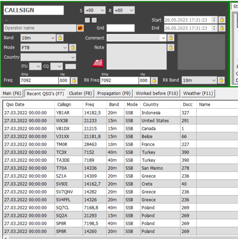

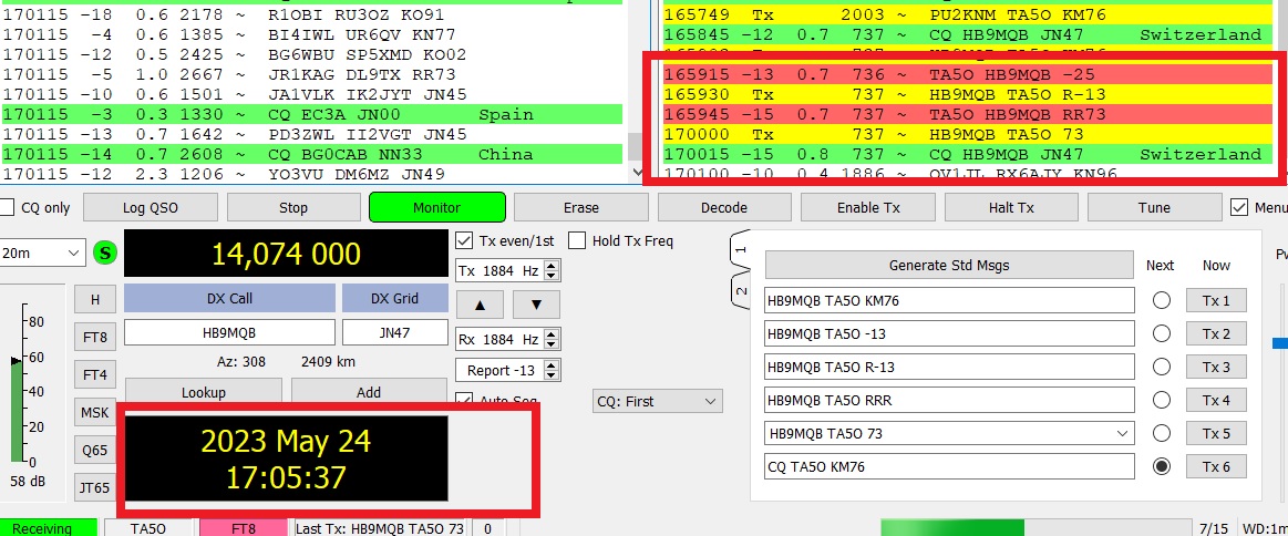

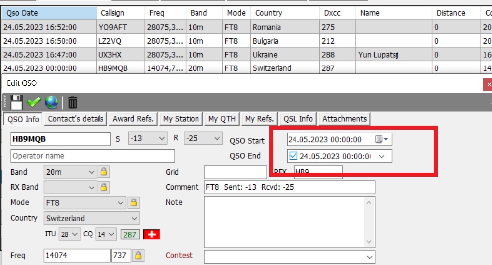

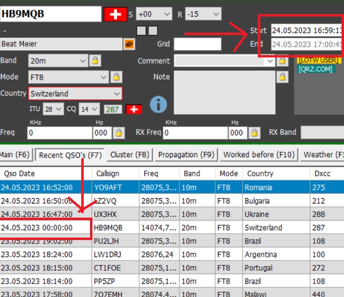

Log4OM records the QSO time as 00:00 while automatically transferring the QSO I made from wsjtx. How can i fix this problem?
You can see it in the attached pictures.
Note: I manually corrected the times of the other ft8 qso.

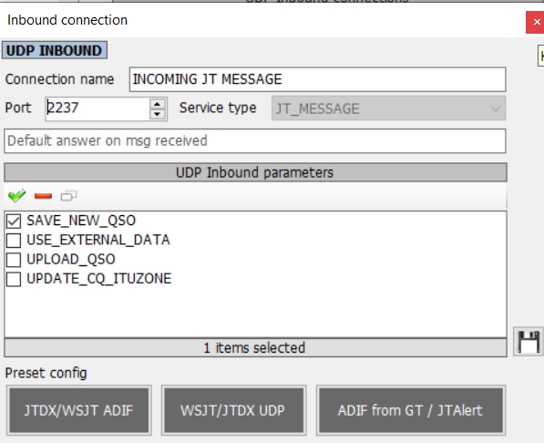

Is WSJTx input via UDP Connections or ADIF input?

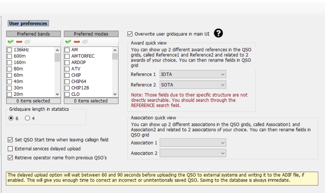

How do you have your "Set QSO Start time ..." set at: Settings / Configuration / User Preferences ?

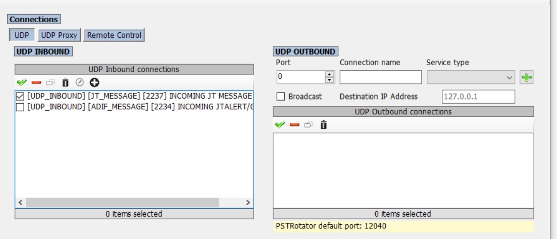

My WSJTx input via UDP Connections is attached pictures.
''How do you have your "Set QSO Start time'' attached picture

When you updated to v 2.27.1.0 did you "delete" your existing/former UDP Inbound Connections and then build new ones using the Preset Config buttons on the Inbound Connections tab?
Based in your images I'm going to guess that you did that and then turned off some of the parameters?
If you simply just 'adjusted' your prior UDP Inbound Connections please "delete" them and then rebuild using the Preset Config buttons.
Now ... if you have already done that and 'de-selected' some of the parameters ... try enabling the "Use_External_Data" parameter and see if that helps or not.
Are there any tic boxes in the WSJTx APP configuration that touches on time, etc.? I just glanced at the User Guide for WSJTx and didn't not anything that stuck out at me with respect to that.

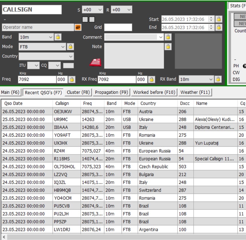

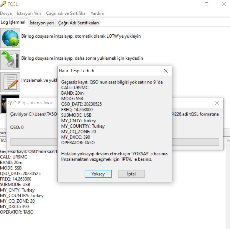

I think this problem is not related to wsjtx/log4om settings.
lotw was giving error ''qso has no time information'' when installing to lotw.
So, I saved the logs and deleted the log4om and reinstalled log4om.
When I uploaded my logs to log4om again, As seen in the attached pictures, the time of all log records was 00:00.
I have been using log4om about for 4 years. Didn't have this problem before. This problem happened after I reinstalled log4om after formatting my computer.
