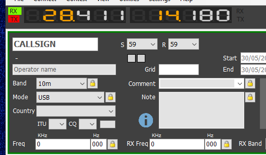

The VFO and fields below show reduced information. ( see attached image )
The displayed frequency in log4m changes with the radio and vice versa.
HDSDR also works the whole way through.
If I negate the connection to HDSDR and setup LOG4OM with direct com port, all is fine and all frequency fields are filled..
Love some help with this.
Thanks ZL1HIM

Omnirig V2 is not from Afreet Software, it´s a modified version by a HB9 OM. We know that this version has problems
working together with Log4OM but the swiss guy don´t make any changes. Latest original Omnirig is 1.20.

Re: Limited VFO displayed
Hello Ian,
Omnurig V1.20 is not an earlier version. It´s the latest one of the original Omnirug and from this year. The originals handling only
max, 2 transceivers and the modified Swiss version handles 4. The mistake with V2.1 is that it not works errorfree with Log4OM
V2 and that could be the reason for this problem. I don´t say that 2.1 is the bad part but it´s possible.
Ian,
To add to Juergen's comments ...
I got an e-mail from the Swiss developer two weeks ago. He confirmed that his fork or version of the CAT application is no longer being worked on or developed and he also confirmed that it does not work with Log4OM.
This the URL where you can get Omnirig V 1.2 that does work with Log4OM along with all the current Rig ini files.
Description: http://www.dxatlas.com/OmniRig/
Download: http://www.dxatlas.com/Download.asp

Guys, success !! :D :D :D
Thanks again for your help. I downloaded the trial of win4yaesu and everything plays happily together now.
win4yaesu + HDSDR (omnirig 2.1) + LOG4OM (omnirig 1.2) and com0com to hang it all together
Will invest in win4yaesu full version.
