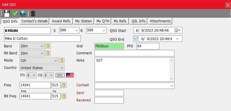

Image of one of the many Edit QSO screens I tried this afternoon as well as my Recent QSO's panel.

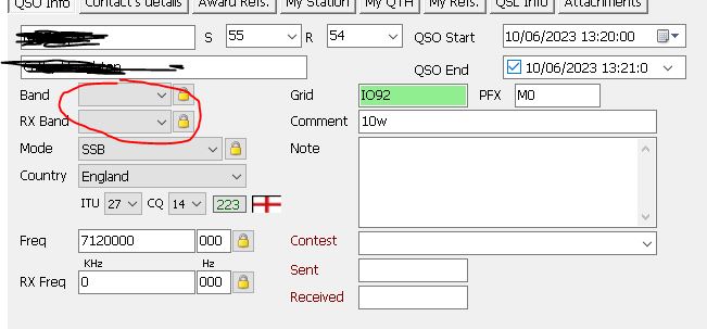

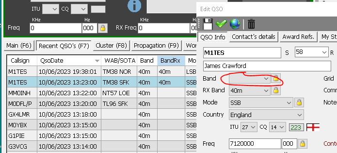

This is really strange indeed.
What I have deduced further is that the empty fields are on QSO that I imported from an ADIF.
If I go into EDIT QSO and change the band and RX band to 40mtr. I save and exit and then go back into edit QSO and it only shows the RX band field filled in.
Any new Manual QSO entries and the fields are OK, No problems
Attached is a txt file rename .txt to .adi
The QSO on the 04/06/23 is a manual input the entry on 08/06/23 is from an ADI entry.
I dont know whether you can replicate it fro this?

I finally found the error.
Importing from one looger app I had the freq as 7100Mhz the other app 7.100Mhz. So missed the decimal point in one of the log entries.
When importing the adi into log4om the freq entry of 7100mhz messed up the band fields for 40mtr.

Check the Frequency .... 7120000 is wrong. Frequency in kHz is 7120 the 3 zeros for Hz are in the seperate Box. A decimal point is also
wrong so the Frequency is kHz only and there´s no decimal in.
