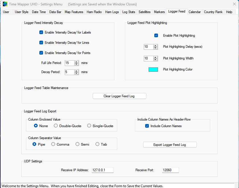

I am currently evaluating EI8IC's Time Mapper program. This program has the ability to plot live Amateur Radio contacts (aka QSOs) that are received via its UDP Feed on a world map and show the Call Sign beneath the map. These contacts can come from an Amateur Radio Log program.

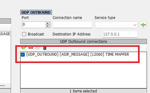

The map program displays my QSO like it should if I use N1MM+ as my log. However I have been unable to make it work with Log4OM.
I have tried various settings of outgoing UDP feeds but none work. I would like to know if it is possible to forward the live OSO being logged to an external program and if so can someone tell me how to do it.
I have looked at various posts regarding UDP on the forum but none would seem to solve my problem. Any help would be appreciated. Thanks.
P.S. If you have not seen Time Mapper it is a wonderful program that can generate a 4k UHD map with numerous overlays including a section devoted to Ham Radio that includes CQ Zones, ITU Zones, IARU Regions, Grid Locators, Ham Prefixes, NCDXF Beacons, PSK Reporter and live logging.

“The Logger Feed will listen for QSOs sent from the N1MM logging program (and other loggers that send in the same format) and display the received callsign on the map, colored by band or mode, and with optional lines and labels.
The Data Bar (the region below the map) also has an option to show details of the latest QSO in large letters: again, this is useful when showing the contest to an audience.
To configure the Logger Feed, enter a Receive IP Address and Receive Port Number to the boxes in the 'UDP Settings' panel.”
As you can see it is preset for N1MM+, but according to the Help File this can be changed to accommodate an alternative logging program that uses the same UDP format as N1MM+
My questions are:
Can LOG4OM transmit QSO information in the same format as N1MM+?
If so, what information must I put into the UDP settings of Time Mapper to enable it to receive this information?
What, if any settings do I have to apply to LOG4OM to enable the transmission of the QSOs UDP information?
Thanks for looking at this for me.
George

Re: Using LOG4OM with Time Mapper
Thanks for the reply.
I saw the note about "live QSOs" and thought it would be similar to the JT_MESSAGE feed. After using the ADIF_MESSAGE you noted, I got the logging to display. I guess I was hoping for more interactive display like GridTracker or HamClock. I think I'll just reconfigure HamClock on my RPi.
I'm enjoying Log4OM, though. Great work!
