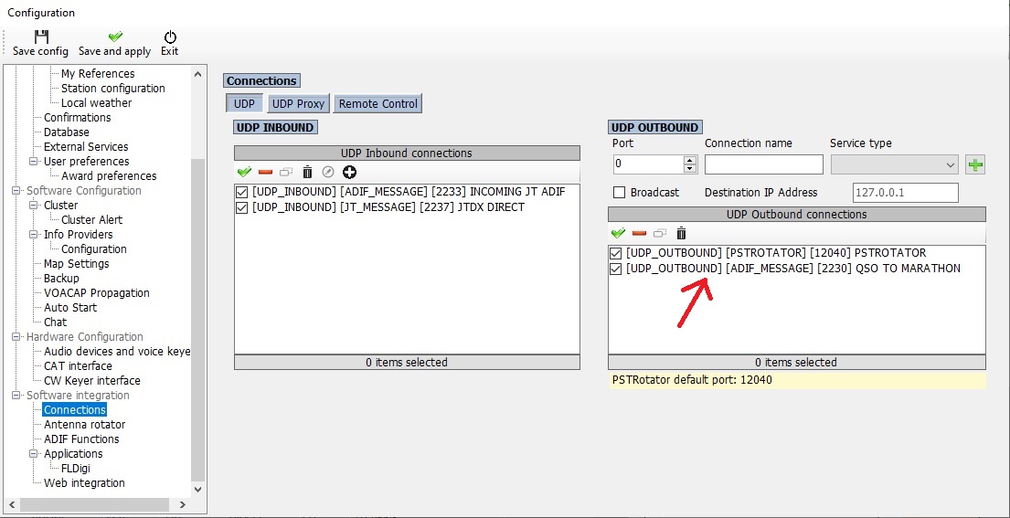

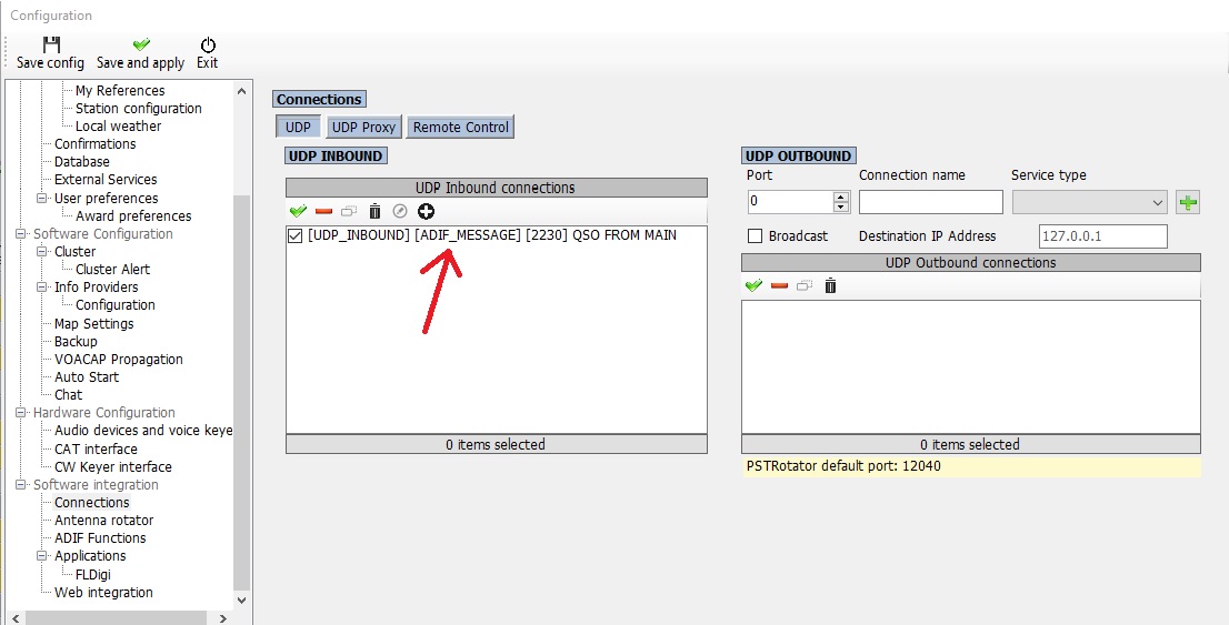

Hi all. I run two instances of LOG40M. One is the "all time" log and the other is for the DX Marathon. The all time log is running on a separate pc that is connected to the radios. The DX Marathon log is not connected to the radios. Now I have been doing back ups from the all time log to the marathon log manually. I recently saw someone talking about using the secondary UDP in WSJTX to send to another pc. This got me thinking. I managed to set up a new Outbound UDP in one instance of LOG4OM and a new Inbound UDP in the other. It works really well. See screen shots below.
