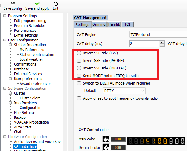

6. Did you try different settings in the Log4OM program config to the check boxes shown below?
I don't use L4OM to control the rig other than to do SSB frequency changes from the cluster screen. If I do data then that frequency CAT command comes from WSJTX to Omnirig with the log passing into grid tracker then is UDP inbound to log into L4OM. That all works fine too.
The only difference on the snip you sent was my CAT delay was 1 where yours is 0. Changed that too but no difference to off frequency change.
Changed the invert for settings and tested that they work putting USB/LSB 'wrong' for example but the frequency offset still remains along with the flipped sideband.
Not sure now it is Omnirig .ini. If WSJTX uses it the same as L4OM as WSJTX is solid in frequency change each time.
I'm using the 101D .ini file as there is no MP version in Omnirig but they are fundamentally the same rig so it shouldn't be the issue?
I'll let you know if I find anything obvious by experimentation but for now 2 sets of double clicks to change frequency it will be.

Good news, looks like your suggestion nailed it. Thank you so much.
Send mode before frequency to radio checkbox was all it appears it was.
It'll be my stupidity not seeing it yesterday as I thought as I wasn't changing modes that wouldn't matter. :roll:
