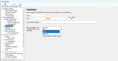

Terry, please see attached screenshot.
- Screen Shot 01.jpg (20.38 KiB) Viewed 1261 times

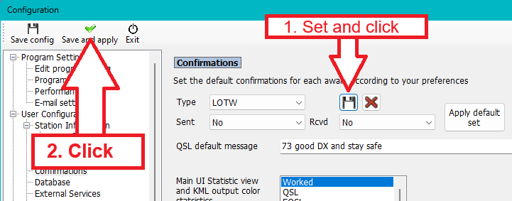

Tony,
I think there is some missunderstanding about that function
Setting the choice of LOTW, eqsl etc and having then chosen the comment type of Yes, No, Requested etc you then click the floppy disc followed by 'save and apply'
Having done this every new QSO that you save will have the LOTW/EQSL/??? status set as chosen above by default.
These settings do not make any changes to existing QSO's you must do that in the QSL manager by bulk or in a QSO edit window.
I have just checked and the choice of confirmation settings is being saved and actioned as the default choice correctly in Version 2.28.0.0

I just recorded the actions and results as below
In the recorded QSO the LOTW status is recorded as set!
