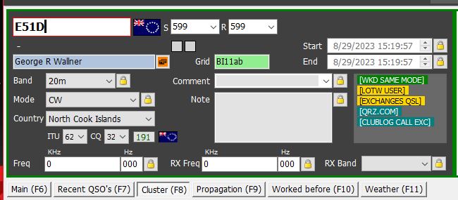

Trevor,
Manual entry of e51d into Main UI at my installation shows North Cook Island.
But then I'm not having any of the FTxx inputs affecting things as I only work CW.
BTW - the current version of Log4OM is: V2.28.0.4
Your version is multiple releases old.
- e51d.JPG (51.47 KiB) Viewed 1562 times
