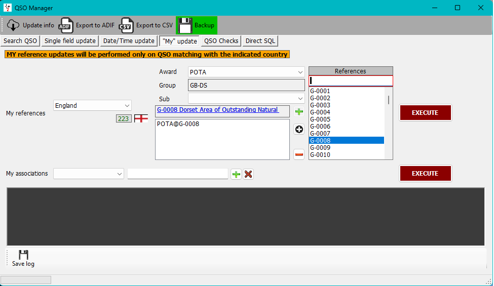

QSO Manager
Select QSO's to be updated
My Update tab
Select your country
Select award type
Select award refence
Execute

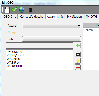

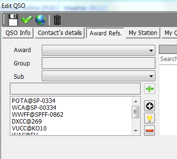

Interestingly, the entered "upadete" worked for stations from Poland, while it did not work for non-Polish stations. Why?
Re: POTA - I forgot to enter SIG INFO

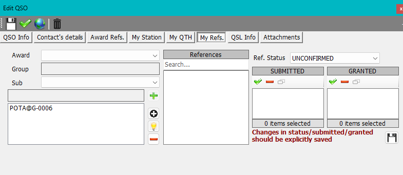

Check the 'My Refs' tab of the edit window your checking the other stations references in 'Award refs'

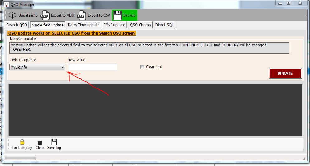

I found the function I was looking for.
"Single field update" - relative to one or more selected records. This is how I entered the missing value of the POTA reference.
