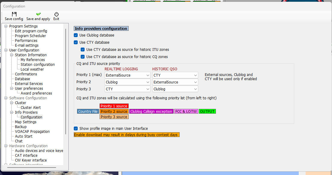

Re: Callsign Mapping
So I did some some adjustments to the info providers configuration and now it is working,
I had CTY as #1 now I have external,
Thank you for the reply,

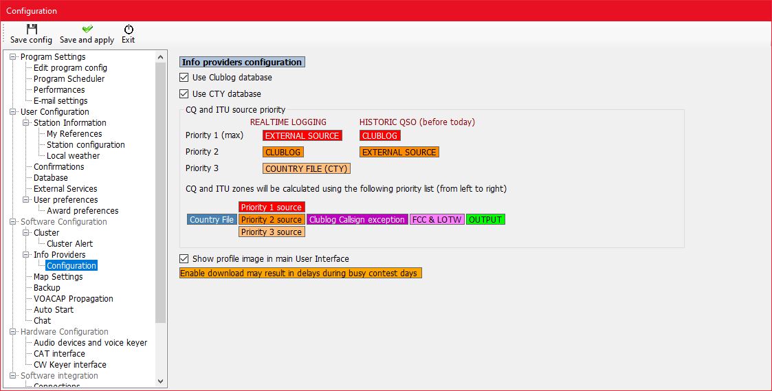

Trevor,
What version of Log4OM are you using? With such adjustments it appears you are not using the "current" version of Log4OM.
Lele made many changes in some releases ago one had to do with the order selection of the Info Providers as they kept getting selected in orders that messed up with the proper search sequence.
You should update to: V 2.29.0.0
Here is what the current Info Providers Configuration screen looks like:
