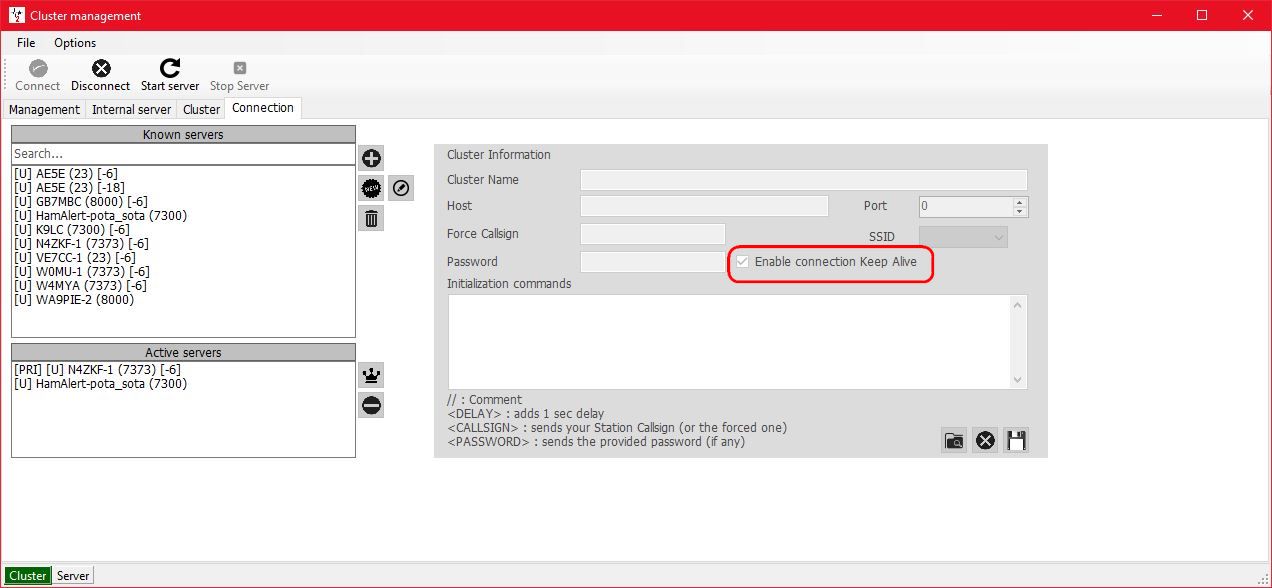

Have you enabled the "keep alive" option for the cluster(s) involved?
- ClusterMngmt.JPG (75.36 KiB) Viewed 11994 times

Hi Nolan,
thanks for your reply.
This box is checked (by default?) but greyed out, so it is even not possible to disable it.. very strange.

It is NOT grayed out when you have the cluster selected to "edit" the parameters of that given cluster.
It is grayed out when you are just casually looking at that panel.
Disconnect your clusters then select one to edit and you will then have that option turn 'active'.
- ClusterMngmt-1.JPG (87.44 KiB) Viewed 11974 times
Re: Disconnection of Cluster after some time
Okay, now I got it but this box is checked by all clusters I have selected..
