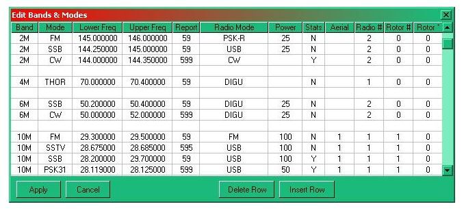

As a more user friendly solution, perhaps a future addition would be for a user-modifiable (txt?) file or user-entry grid in the program. Here is an example from another logging program. This would give each user the option to construct a personal bandplan appropriate to their national regulations and license class.
It would also give users the opportunity to completely screw up their band plan and operate illegally plus the chance of transmitting in areas that could disrupt emergency services and military opps.
It's safer and far easier doing it the way we do now and just modifying the band plan as required the few users that have issues with it.
Revised band plan follows shortly
