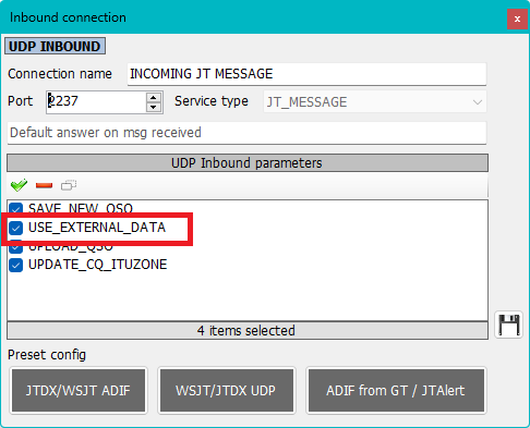

I work with WSJT-X, LOG4OM and QRZ.
If there is an incomming call the grid is olny in 4-digits (in WSJT-X) and LOG4OM gives me a 6-digit square.
When I log the QSO it is also in 4 digits (in LOG4OM) , and its goes to QRZ also in 4 digits.
there was a short time that all things were good.
I want it all in 6 digits.
LOG4OM 2 v.2.2.0.0 (v.2.26 does the same)
WSJT-X v2.61
73 de PE2GVR

Log4OM logs what is coming in via UDP from WSJT-X and that is only a 4 digit locator. What you see in the Log4OM Log Window
is not what will be logged. Means Log4OM does not overwrite the incoming Locator from WSJT-X.

Oke, thank you.
But how coms that other people have 6digits in their QRZ-log.
I don't think they fill out by hand.
Greetings de PE2GVR

Edit your UDP setting for the FT connection to 'use external data'

It doesn't work.
WSJT overwrites the grid-locator with four digits.
