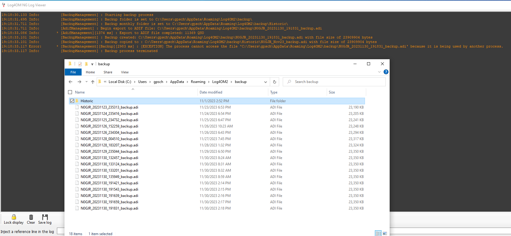

In an attempt to get with the times, I'm attempting to upgrade from Log4om2 v2.25.0.0 to latest GA 2.30.01. Step 1 on my part is to do a Backup. When I select File -> Execute Backup, I see "Backup Error. Check Log." Viewing the log file, either historic or real-time, shows "[EXCEPTION] The process cannot access the file '...\backup\NOGJR_20231130_191831_backup.adi" because it is being used by another process. Backup process terminated.". I do see an appropriately sized backup.adi file created in the backup directory however I don't see an associated .json file created in the Historic subfolder. This is on an HP Envy, I7 processor, 16 gig RAM, Windows 10 Pro.
Images of the Log with directory contents attached. I've spent quite a bit of time searching the forums and manual. I've also tried using the Windows Resource Utility to identify what other process may be locking but it looks like its just Log4OM2. I've rebooted and inhibited any associated programs such as WSJT-X, but still same backup failure notification. Any help would be sincerely appreciated.

In blowing up your images provided it appears you did not specify locations for the backups and with the number of adi and json files you did not set up a file-rotation so you have a huge number of files. They are all first in / first out type ... so the latest files are the most current.

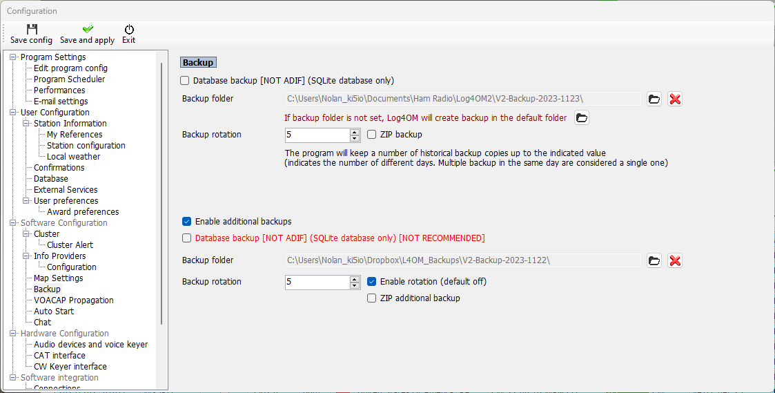

Note my backup settings in the image below.
- ki5io_backup.png (64.4 KiB) Viewed 9973 times
