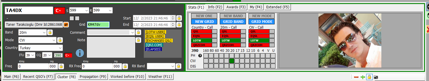

TA4AU wrote: 02 Dec 2023, 20:43 My friend TA4DX is lotw user registered and upload all log lotw but log4om not shown lotwuser on display ?
Mehmet,
He shows up as an LOTW user in my installation. See image below.
My QRZ.com lookup is a "paid for" XML Data Membership which will show more detail.

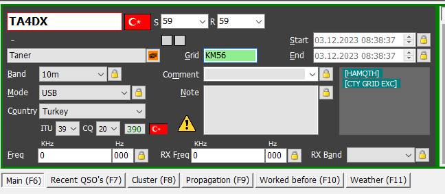

Re: Lotw users
I am using HamQTH for lookups and on HamQTH he is also not show´n as a LotW User. Think your friend has to be
update his entries at the different services ?
