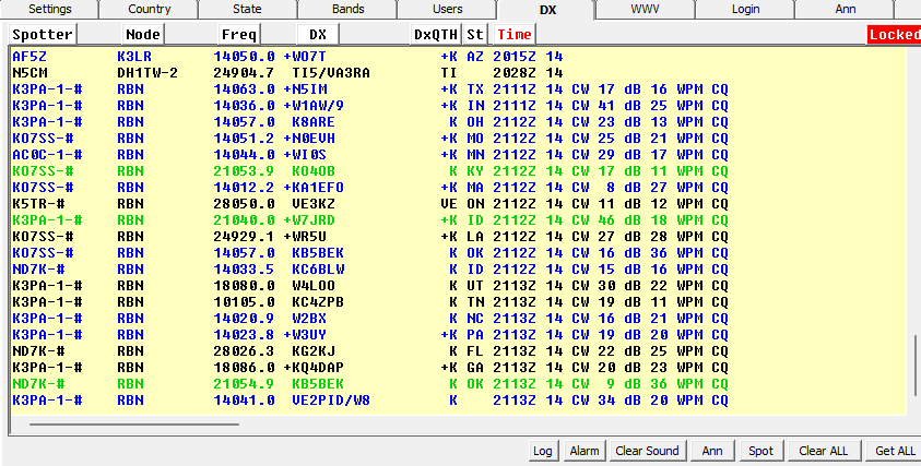

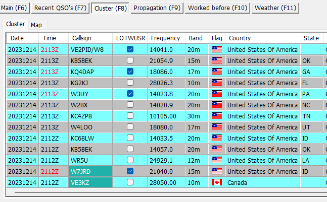

Below are a couple clips. One from the ve7cc-1 cluster feed in Log4OM and a one from the CC User view of ve7cc-1 that should pretty much most of the same spots.
A few variables as I also have two other clusters running in Log4OM along with ve7cc-1.
I'm not seeing those wide of date/time margins.

Scroll back so CC user shows a spot from the previous day (13th) and see what day shows in the L4om cluster.
Here it still shows the 14th for spots from yesterday.
