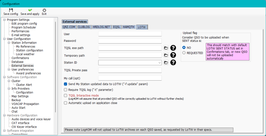

I'm wondering if anyone can explain how LOTW works with LOG4OM using a second LOTW certificate.
Several hundred contacts I made back in the 1970's using my original call, WN2SQQ, were part of my database. The station call was entered as WN2SQQ. These were uploaded using my LOTW certificate for WA2SQQ. I mistakenly thought that LOTW would have searched for any calls under WN2SQQ. Later I discovered that I needed to apply for a second LOTW certificate for WN2SQQ, which I have done.
I assume that I now need to do a bulk edit in the QSL info and change all the WN2SQQ contacts to "QUEUED", so they can be reloaded to LOTW.
My question is, how and where do I tell LOG4OM to use the WN2SQQ certificate?

Bob,
If its a one off download to update the old QSO's then just change the details in the config of Log4OM
If your likely to need to use both regualarly then set up a seperate configuration of Log4OM for each call

Re: Can LOG4OM use 2 LOTW certificates?
It would likely be a one time requirement. What is unknown, where in LOG4OM do I designate the LOTW certificate for my old call, for this one time update?

OK Bob,
Assuming that you have TQSL and BOTH certs from ARRL installed on the Log4OM PC, then.........................
1. Whatever call sign and details you enter and save here will determine what QSO confirmations are uploaded to and downloaded from LOTW - Be especially carefull to use the correct station ID
2. When you view the awards statistics in Log4OM you can select which station call results you want to view or a combined result by leaving the station call shown below empty (Blank)
3. As for displaying the combined results on the LOTW website I thought there was a setting in LOTW that 'LINKED' all of your registered call sign? but you need to ask LOTW about that, I cant advise!

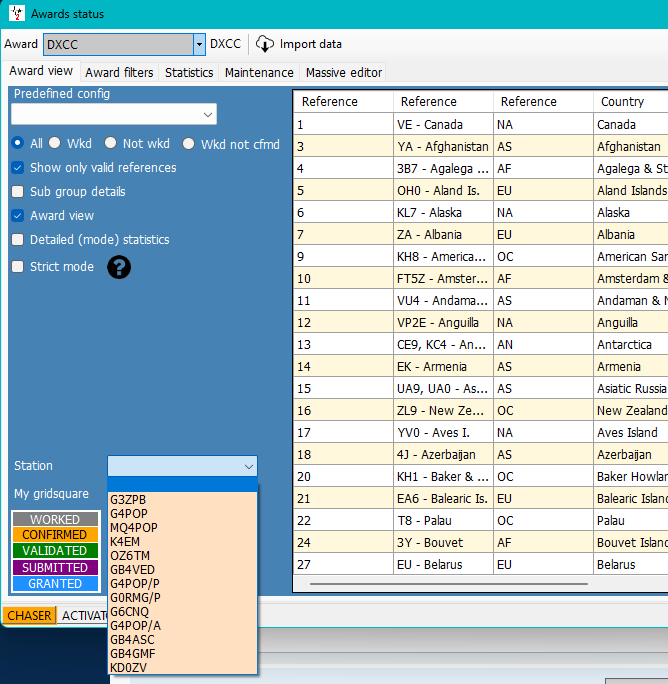

The only other problem (very minor) that remains unsolved is with View / Award Status / DXCC
As you said, if I leave the drop down box empty I see my entire DXCC list. In my installation, I see 3 calls - WA2SQQ, WN2SQQ and a third call that I can't find in any contact. For all the other contacts where this occurred, I used the drop down window to find the file that had the bogus call entered in the Station Call field.

If you click the third call do any worked entities display in the DXCC mixed award matrix?WA2SQQ wrote: 28 Dec 2023, 15:17
If any do show worked for that call did you try clicking the marked square in the matrix to display the QSO's related to that entity/band that was so marked?
That's the strange part of this. The call in question is UL7RE. If I display contacts for that call nothing shows up in the DXCC contact grid, and I never worked UL7RE under any call. For the other calls I used that method to ID those contacts. I also figured out why they were there. These were mostly DXpeditions and I noted the ops call in Station Call - my error.
Is there any way to manually delete this UL7RE reference?
