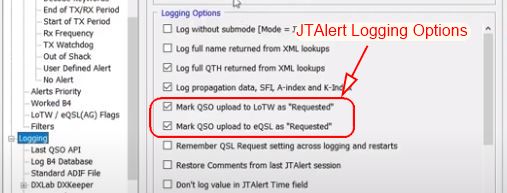

I happened across a Y/T video going over some FTxx APPs installation and did a screen grab of the JTAlert Settings / Logging portion where there is a toggle on/off option to deal with the "Requested" item.
Fuzzy screen clip is below ....
- jtalert_logging_options.JPG (22.03 KiB) Viewed 53217 times

Thanks for the detailed location of those JTAlert setting options. I found them with your help, and indeed, they were checked. I unchecked them and I'm confident that fixed the problem. Because of some damage done to my wire antenna in yesterday's windstorm here in SC, it will take a day or two for me to repair the antenna and test the result of the JTAlert change, but I think you hit the nail on the proverbial head.
