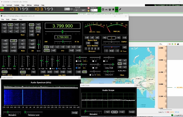

I start LOG4OM version 2v.29.0.0 with Omnirig and Win4YaesuSuite-v1.440-x64.
Comports been set using com0com-2.2.2.0-x64-fre-signed.
The problem. Frequency differs
Win4YaesuSuite Frequency correct. 3799
LOG4OM not correct 103.799
Has anyone an idea why
Thank you DJ9UN

Thank you to have moved to support, i wish someone can give me a help.

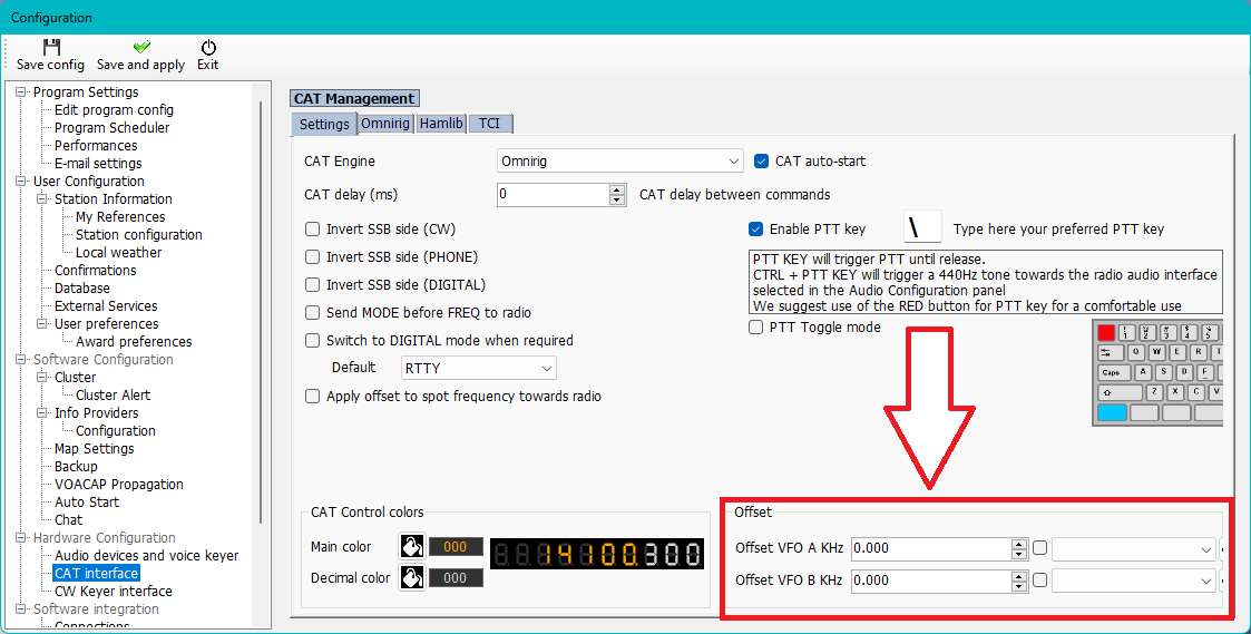

Looks like you have an offset in the Log4OM - Program config - cat tab

Thank you for the information, but LOG4OM isn't set offset.
LOG 4OM and WIN4YAESU1.png (109.06 KiB) Viewed 1816 times
Re: Log4OM with WIN4YAESU Frequeny differs
What about here?
Have you checked the Log4OM logfile in Trace mode to see what information the other program sends - Its not always a fault of Log4OM!
