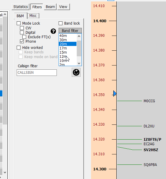

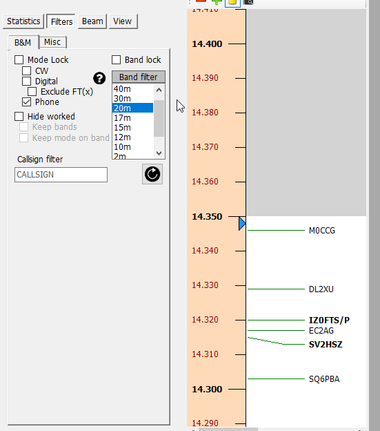

When moving out of band, the whole band map is colored grey.
2024-01-28 12_27_06-LOG4OM 2 v.2.30.1.5 NOK.png (22.5 KiB) Viewed 1907 times
2024-01-28 12_26_49-LOG4OM 2 v.2.30.1.5 OK.png (26.08 KiB) Viewed 1907 times

Alex,
What IARU Region have you selected at: Settings / Configuration / Station Information / IARU Region ?
In my case I have have IARU #2.
Have you modified your band maps?

Re: Coloring of band map inconsistent
You should select region 1 for Europe and restart Log4OM after changes
