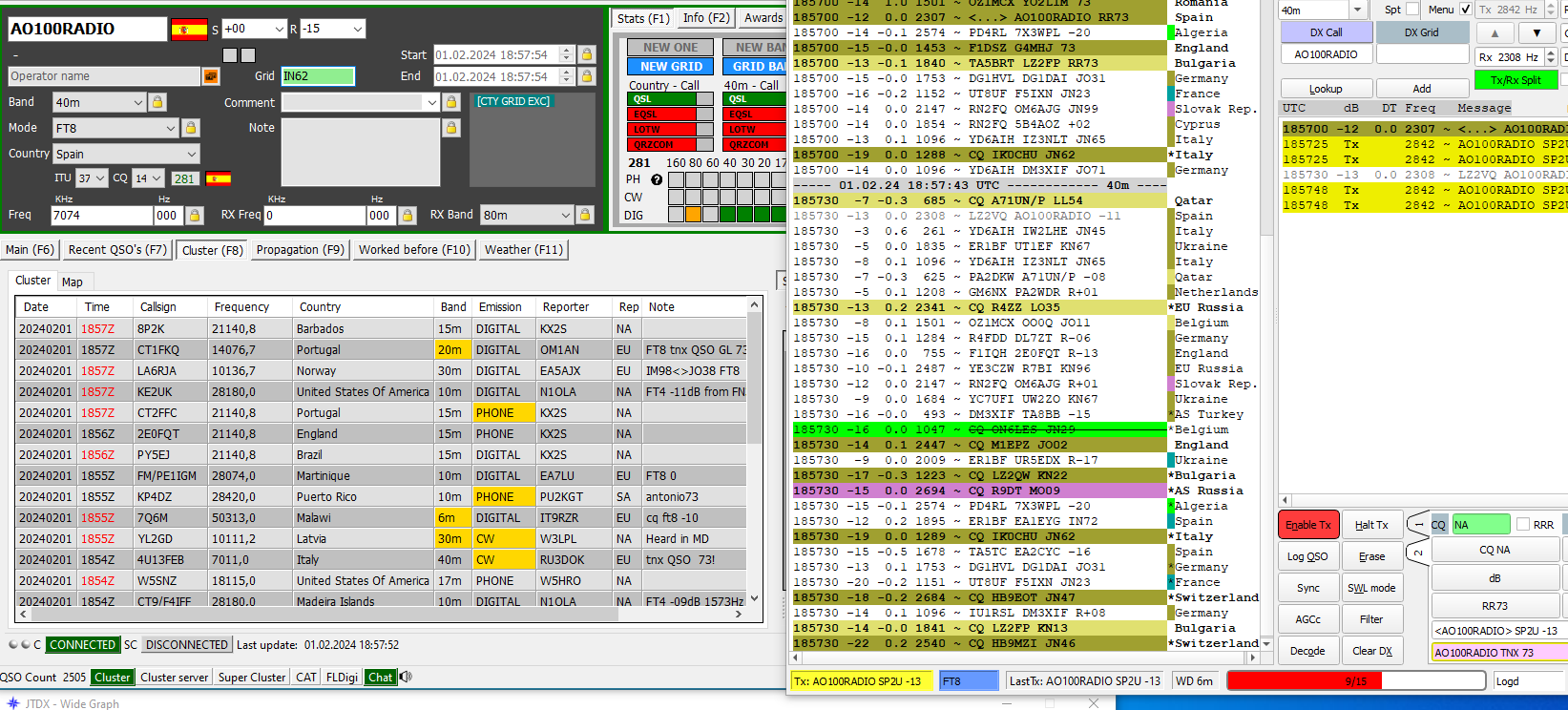

Hi. I use this log for few years but I decide change win from Win 7 to Win10 and Log4OM v1 to Log4OM v2.
And now I have problem. In past, when I connect with any station I always had info (name) in "Operator Name" window. Now anytime I've QSO I see info near callsign - data lookup and nothing more.
No information about QRZ, no name from QRZ.
I reinstal few times Log4OM, I uninstal Antyvirus Awast, and still nothin.
The best is that I used Win7 and Log4OMv1 was all superb.
Could any help me, pls

Your only a 'Ham' member of QRZ not a paid XML subscriber so you wont get a full lookup because QRZ restrict it for Ham members
