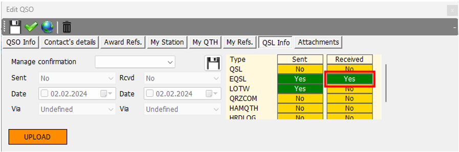

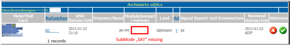

I am working usually via Satellites and a valid QSO confirmation requires the submode "SAT". Unfortunately, several OMs are not aware of this and send me eQSL's with that missing submode. As a result, the QSO remains unconfirmed in eQSL which is correct. The problem is, that Log4OM doesn't take care of this and shows me in Log4OM: Eqsl Received "Yes"
It seems to me that Log4OM doesn't read from eQSL webpage the information if a QSO is confirmed or unconfirmed. Rather it looks like that Log4OM is doing an own check and this check doesn't consider the SubMode.

Could the problem mentioned below be fixed in a new version?
