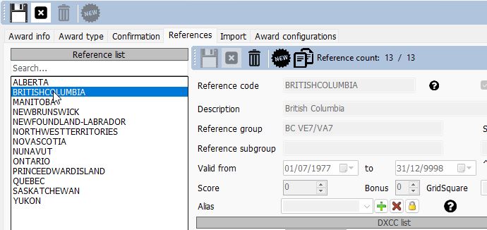

Canada has 12 provinces which are described in the Stats.csv file like this:
2024-02-28 10_18_49.jpg (14.18 KiB) Viewed 10709 times
For the RAC to be taken into account, simply put in the "Comment" field the name of the corresponding Canadian province (for example: Ontario) and Log4OM detects that this corresponds to the "Ontario" value for the RAC and therefore I find this value in my reference field in which I chose to display the RAC (Settings / Program configuration / User preferences Ref1 to Ref6)
Everything works very well but what I don't understand is this:
Why if I type "British Columbia" (in 2 words) in the "Comment" field Log4OM finds that it is "British Columbia" whereas if I type "New Brunswick" (in 2 words) Log4OM does not find a match; but if I type "Newbrunswick" in 1 word it works normally
It doesn't matter I can type in just 1 word in this case, it's just to understand
Here is also the detail of the description of the RAC Award which I modified a little but in both cases the values seem similar
2024-02-28 10_20_08.jpg (44.86 KiB) Viewed 10709 times
2024-02-28 10_19_51.jpg (40.58 KiB) Viewed 10709 times
So if you could tell me WHERE Log4OM will look for the matches? and in this specific case what should I modify so that Log4OM accepts both cases by typing the province in 2 words
