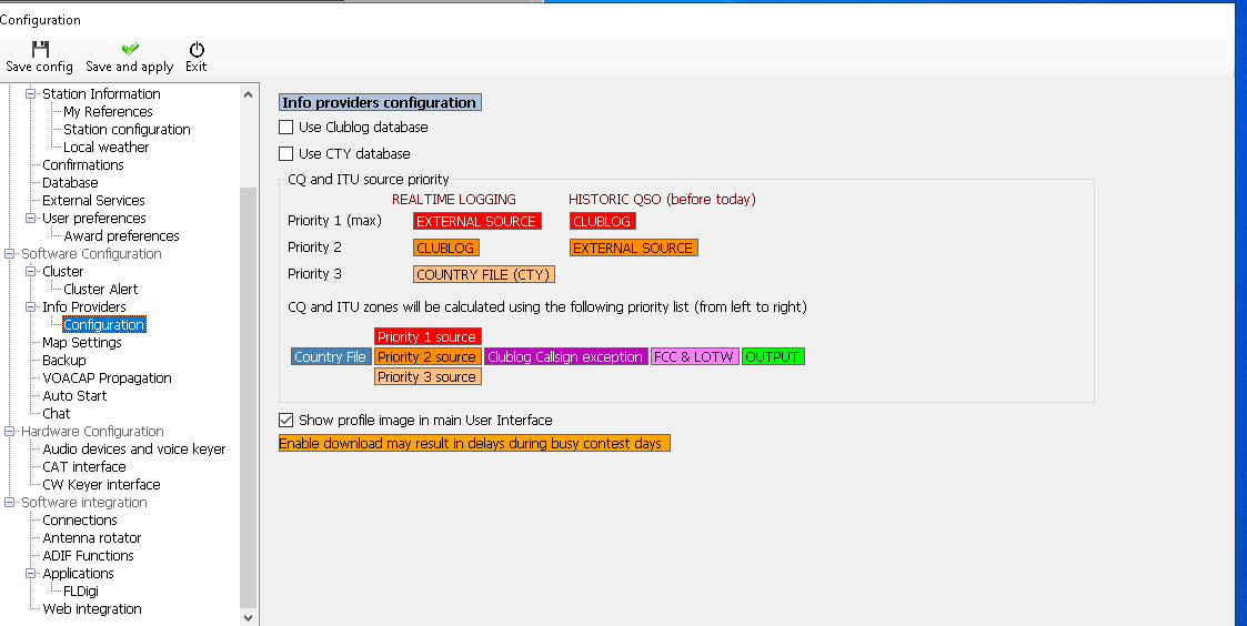

Thanks for responding Terry. Tried both with and without checks and both times I logged out of Log4OM and logged in still changing the ITU and CQ Zones. I looked in the manual it shows them checked. I got something a foot. LOL Did you just out of curiosity try to log VA3WHU to see if you have the same problem? Here is the screenshot.
Screenshot (18).png (37.46 KiB) Viewed 3016 times
Is there somewhere else I need to look? It seems the CQ and ITU source priority doesn't change don't know if it should.
Thanks again Terry for the response.
