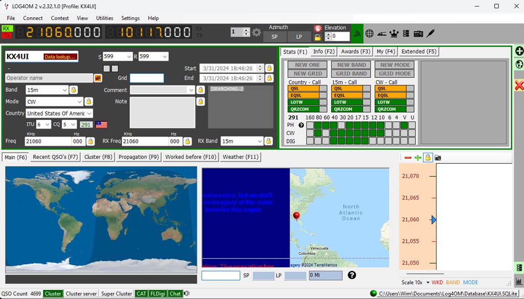

After updating to v2.32.1.0 I experienced an extremely slow Data Lookup when entering a call sign in the input field. It takes well over 3 minutes before Name, Grid etc. gets populated and almost double that to load the right side map if lucky. Sometimes (when patient) a notification pops up saying: [WARNING SLOW RESPONSE FROM EXTERNAL SOURCE: 14559.8253].
The right side map stays green completely green (at that initial zoom level) with the red grid box and blue line drawn. When zooming in no map details are loaded. When zooming out (substantially, blurry contours of my state become sort of visual after a substantial loading delay. Pin of own QTH is drawn in as overlay correctly. Grid position box of the target seems to be plotted in the correct direction and distance. Sometimes the right side map shows "Exception: The Operation has timed out" in red text, while the map shows in blue text: "We are sorry, but we don't have imagery at this zoom level for this region".
I noticed something funny with the QRZ button on the right (globe icon), now it works as a toggle like on (green) off (dark and blue). However no matter what state, when pressing the button the QRZ page of the call sign comes up practically instantly.

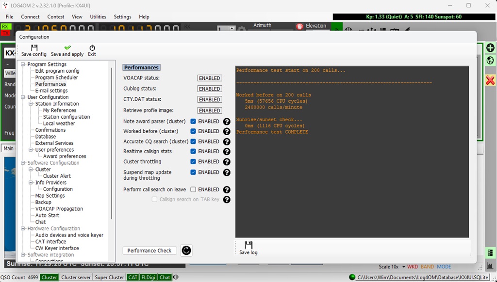

Try settings\Program Config\Performance - Click the 'Performance check' button
With Win11 I get the following
Worked before on 200 calls
10ms (105424 CPU cycles)
1200000 calls/minute
Sunrise/sunset check...
4ms (44420 CPU cycles)
1500000 calls/minute
List of 200 call signs
5433ms (54331061 CPU cycles)
2208 calls/minute
Callsign statistic search...
2ms (21906 CPU cycles)
6000000 calls/minute
VOACAP test...
Performance test COMPLETE
You could also try turning of Voacap

Re: v2.32.1.0 Extremely slow Data Lookup after entering callsign.
@G4POP, Thanks for the quick reply!
My results with only "Perform call search on leave" disabled. Everything else is enabled. (unchecking the boxes in the performance tab didn't cause any substantial performance gain). Disabling VOACAP didn't make a substantial difference either.
Performance test start on 200 calls...
6ms (65332 CPU cycles)
2000000 calls/minute
0ms (992 CPU cycles)

I tried the Performance test again and it doesn't give more info than posted earlier. (Screenshots below)
Also added is the report from the Self-help in the Help menu. I only X-ed out my passwords. (txt file under the picture)
Cheers, Wim - KX4UI

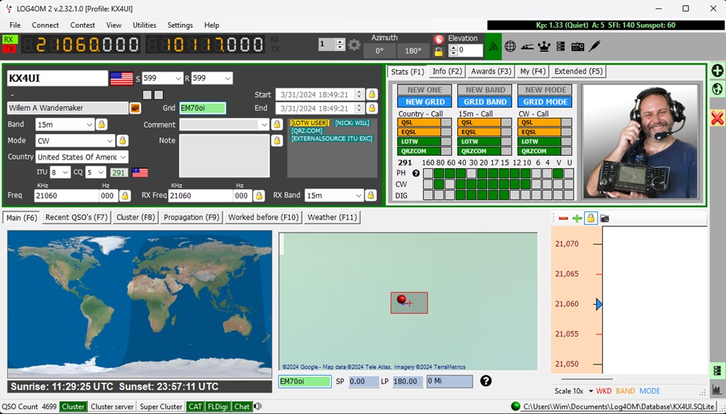

Here are two screenshots with:
1- When entering a callsign. (Note the time in the Start field)
2- When the DataLookup result poped in. (Note the time again).
As good as a 3 minute delay as I lost a few making the screenshots.
Also note the right side map...
Cheers, Wim - KX4UI
