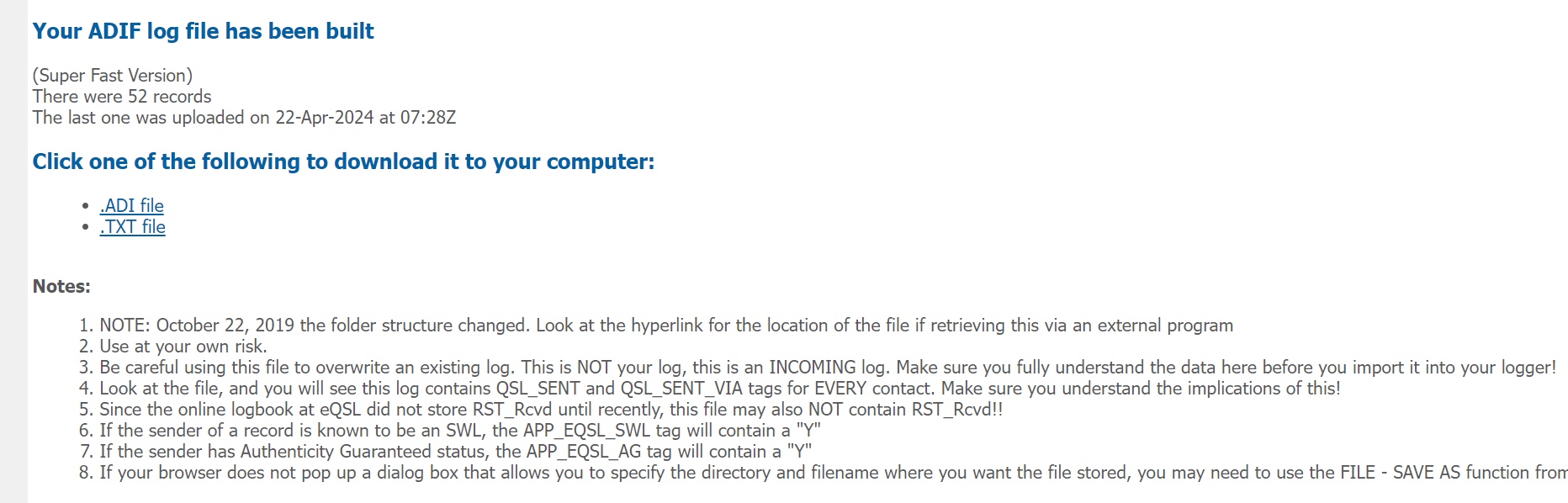

When i use the log and make the same query as webservice i noticed EQSL comes with an interface and question to download in .txt or in .adi this could explain the end result > none

Is it possible that there is no search target because the eQSL.cc account profile you are trying to acquire does not match the eQSL.cc QTH nickname specified in the Log4OM user configuration?
