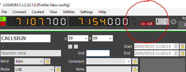

Hello good people. I have been using LOG4OM for a while and really enjoy it's features. However, I have a recent problem that has developed and I hope you can assist in sorting it out. The problem is this: the instant I turn on my radio, the red transmit icon shows on the radio and the "on air" indication shows on Log4OM. The radio is rendered inoperable.
I an using the OMNIRIG setup for the CAT and I have checked to see that the settings on the com ports as well as the OMNIRIG/FT991A are all okay
Please assist as this effectively renders the CAT function (and the radio) inoperable.

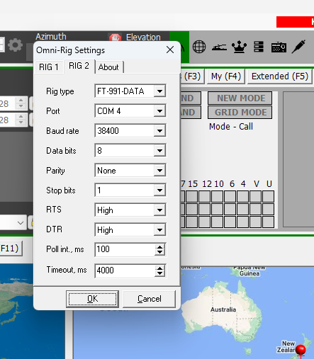

Either RTS or DTR settings wrong in Omnirig or incorrect 991 com port selected is my best guess

These are FT-991A Ominirig settings that work for me.
