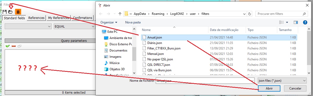

I created several filters a long time ago and they are saved in the conventional folder.
Everything always worked perfectly.
Today trying to use it, I verify that the filters exist, are in the folder, however choosing a filter it is not loaded.
I don't know in which version this started to happen, since I haven't used them in a while.
To test, today I created a filter, I recorded it and this filter I created today, is loaded perfectly.
To see if even though the filter exists in the folder, it would be empty, I opened the JSON file in the JSON Edit file online and the filter is fine, it's not empty. Thank you for your help. I'll attach a picture so you can give a better idea.

Manuel,
I think that some time ago we made some changes that required filters to be re-made because the old ones would no longer work after the update.
I dont have time to search the release notes but it was several releases ago

I was the cause for that filter update. Filters with the "IN" parameter were not being properly saved for future use.
It was V 2.29.0.0

Thank you very much for your quick and very helpful response.
I followed your suggestion and recreated the filters according to the ones I had, recorded and I'm very happy to confirm, that everything is working very well, as before. Thank you very much for your help. :D
