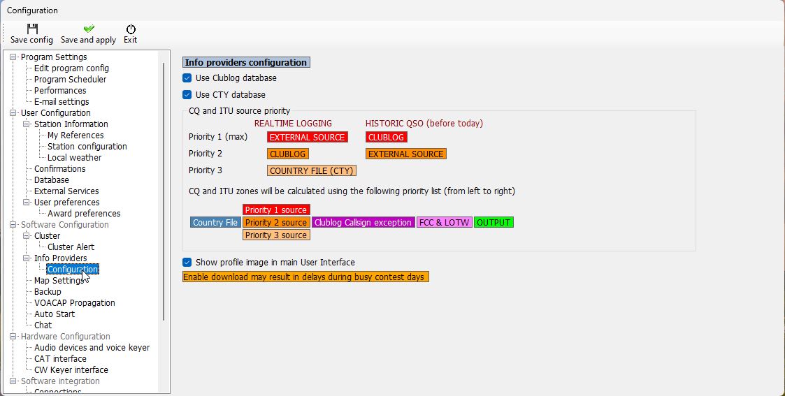

G4POP wrote: 14 Jul 2024, 22:30 What online lookup source are you using?
I'm not sure I understand the question?
2024-07-15 08_38_41.jpg (80.26 KiB) Viewed 2296 times
2024-07-15 08_38_49.jpg (84.34 KiB) Viewed 2296 times

Re: CQ zone problem during an import
Try un-checking 'Use Cty Database'
Post by F6FLU »
Tested but it doesn't change anything I still get CQ=5
