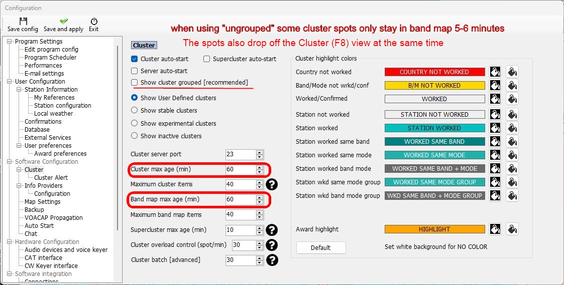

When selecting the 'cluster ungrouped' option I have noticed that spots are not 'sticking' to the Cluster (F8) or Band Map for as long as I have the "age" (Cluster or Band Map) set for.
In many to most cases the spots appear for maybe 4-5 minutes and maybe some longer. Then they just disappear.
When selecting to 'cluster grouped' option the same spots do not disappear in the 4-5 minute time span.
Running with 'grouped' or 'ungrouped' presents different frustrations. When using the 'grouped' option if I happen to send a spot it will very seldom show up in the cluster (F8) or Band Map.
However, if I am watching my CC-User cluster display the spot is there and does go out across the cluster system. Log4OM with its programming with the "grouped" option blocks such spots in many cases.
My biggest concern is the 'disappearing' spots when using the "ungrouped" option.
Thoughts ??
