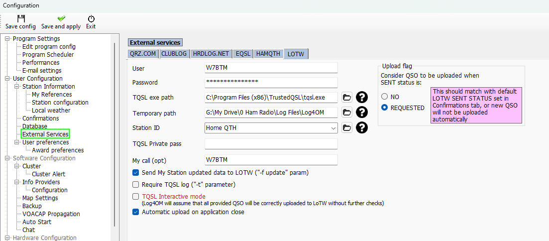

I have configured Log4OM to upload to LOTW on program exit... but it is not working at all. Not even a notice or error, just... nothing!
I have a verified login to LOTW. My Station ID is retrieved from Tsql so I assume that connection is working.
Upload to QRZ is working fine.
Also, my current connection settings work fine with WSJT-x, OmniRig and several other programs.
Here is a screenshot of my configuration page... is there something wrong with this?
Thanks!
Log4OM Not Uploading to LOTW.jpg (113.92 KiB) Viewed 1638 times

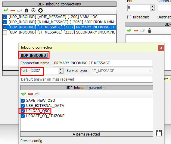

Here are my UDP connection settting:
Log4OM UDP Connections.jpg (56.07 KiB) Viewed 1636 times

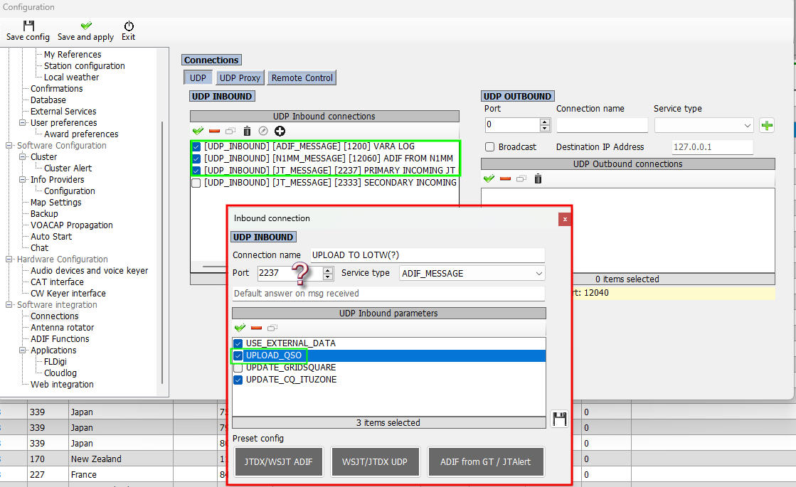

Thanks for the reply.
I did NOT have an "Upload QSO" UDP entry. I do have them for other connections that are working.
My usual problem is being confused by port number selection.
Also the instructions on page 238 do not specifically mention LOTW, so I assume this is a generic connection that will just work.
See screenshot below of my possible setup... will this work using the same port numbers are my other connections?
Thank you!
Possible UDP setup for LOTW.jpg (161.05 KiB) Viewed 1606 times
Re: Log4OM not automatically uploading to LOTW
Bruce,
Why add another UDP inbound with yet another port?
Why not just 'edit' the existing JT Message on Port 2237 you already have in place?
Edit that existing port and tic the box to upload the QSO.
Give that a try first and see how things shake out. Adding more port numbers only just confuses the bee-jeebers out of things and 'me' as well.

So, my "inbound" setting on port 2237 already had "upload QSO" checked!
I just dont' understand the UDP message system well enough. Why is an inbound message used when uploading TO another program (LOTW in this case)? Why isn't that an "outbound" message?
Anyway, something must still be wrong....
UDP Inbound Port 2237.jpg (68.45 KiB) Viewed 1574 times
