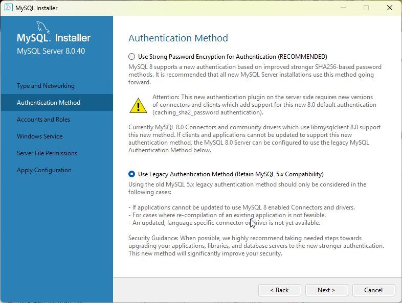

For what may be of interest to the community, I report the outcome of my recent tests.
I installed MySql 9 Comunity Edition which worked very well with excellent performance with Log4OM (although at the moment the Oracle workbench is still at the previous version and is not fully compatible).
In the end, however, I had to install MySQL Community Server 8.0.40 because from my tests it turned out to be the only database server version that still has the possibility that allows me to use "Legacy Authetication"
At the moment legay authentication seems to be a requirement by "JT Alert", a utility that I often use and that I don't want to abandon as it is very well made for my preferences.
MySQL version 8.0.40 in any case is working pretty well.
Best 73 de Rick.
