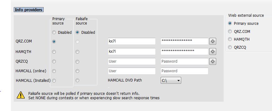

This makes me think it has something to do with callsign lookup on QRZ.com. I have a reasonably good WiFI connection in the shack, and don't typically have a problem with response from QRZ.com, In fact once when this happened I looked up a callsign manually on QRZ using a browser while Log4OM was hung, and it went quickly on the browser. Here's my setup for "Info Providers: (I disabled HamQTH because it seemed pretty flakey).
I may just try disabling info lookup to see if the problem stops. It's cute, but not a critical feature for me.. I'm happy to let the other guy tell me his name

- InfoProviders.jpg (31.38 KiB) Viewed 630 times
Re: Locks up when entering callsign
Charlie,
There are a few things you can 'turn off' to test to see if they improve performace.
1) Turn off VOACAP. Lots of data to/fro and can slow things down, especially with an older PC. Personally I never use VOACAP ... just don't feel it does much for me and my operating. Go to: Settings / Configuration / VOACAP Propagation
2) Turn off profile image: Go to: Settings / Configuration / Info Providers / Configuration Untic 'Show profile image ..."
3) As for not selecting HamQTH as a 'backup' Info Provider ... that won't make any speed difference. HamQTH is often quite speedy. QRZ is the location that tends to have slow responses. I get them from time to time as well. HamQTH is self-managed by OMs about the Globe and the data that is there is only from each individual OM who takes the time (if they choose) to fill it in.
4) Having an older/slower processor PC/laptop you will notice sluggish performance especially when you have a cluster connected and if there is a big participation event happening the clusters are slammed and that traffic will cause one's Log4OM to slow down. Especially with an older PC with a slower processor. I do a lot of filtering for my cluster feed at the CC-User APP that controls my feed from ve7cc or ae5e, etc.. I also adjust CC-User to only send me (as best as possible) only CW spots. I don't work SSB or any FTxx and such modes. I'm 100% CW in my shack
Anyway ... a few things to ponder.
