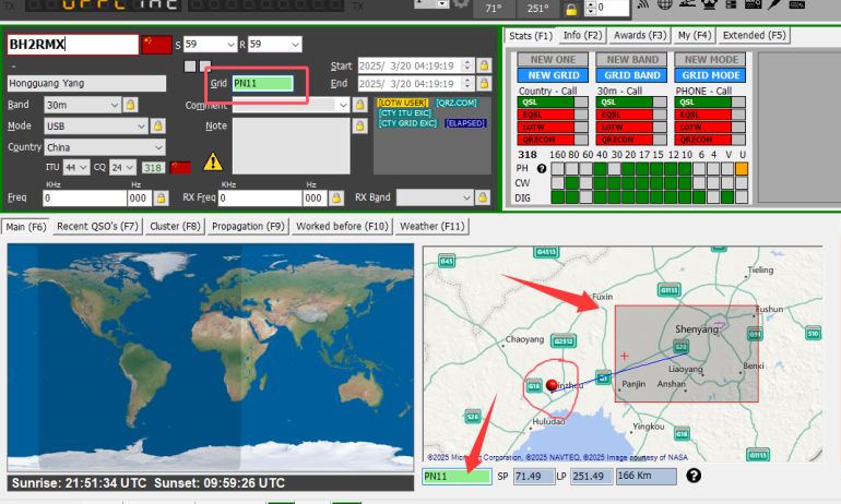

bh2rmx
Posts: 9
Joined: 20 Mar 2025, 01:30
Re: Recording of Grid Squares
Post by bh2rmx »
I have the same problem. I have set all the settings I could find and the situation has not changed. Should I wait for the next update?
