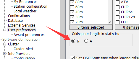

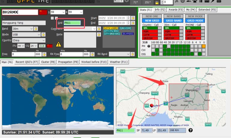

How come your grid display is set to 6 characters? Mine is 4 characters. Is your setting different from mine?
I hope the grid display error will be fixed in the next version upgrade. I also hope that it will be the default 6 characters without modification. now is v2.35.1.0
