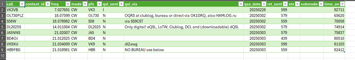

Exporting selected contacts from the QSO Manager produces for some random contacts a missing date and time in the entry row.
The missing date/time information seems to be connected to the CSV Field selection of "qsl_via".
When "qsl_via" is selected some contacts missing the date/time information, while when "qsl_via" is not connected the date/time information is present in all exported connections.

I cant emulate this issue can you post a screen shot showing QSO's with missing time and also with correct time please
I would also like a complete list of the fields selected in the export because it could ba a combination of a couple of fields selected causing the problem.

Hi thanks for the reply.
I added two files which might help in a ZIPED file
a) ADIF export of a 8 contacts
b) Excel file created from the CSV file, the header showes the field selected.
I tried to attach the whole SQL log but its to big, if it is required let me know.

Using your ADIF file imported into a new database and with the field selection exactly as your Excel file in our QSO Manager Excel export routine I get a perfect result, see below:
