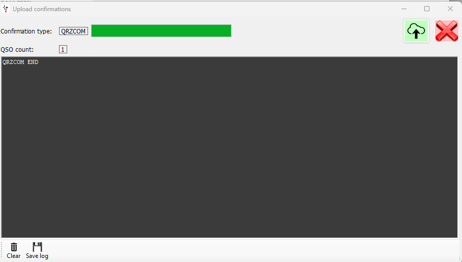

I have the problem that I cannot upload one particular QSO to QRZ.com, please see the attached screenshots.
What could be the problem for that and is there a way to get it uploaded?
My subscription to QRZ.com is active and the automatic upload does also work but this QSO/callsign was not uploaded automatically.

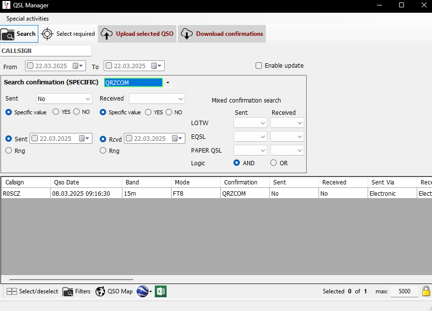

In the second picture, the QSO doesn't look like it has been selected. Either click on the QSO to select it, or click on "Select/deselect" in the lower right corner. When selected, the QSO should have a blue highlight on it.
Also, check on QRZ to see if the QSO was actually uploaded, even though L4OM say otherwise. I have noticed that a QSO gets uploaded automatically, but once in awhile it doesn't get marked as uploaded in L4OM.

it was selected, I just did not screenshot it.

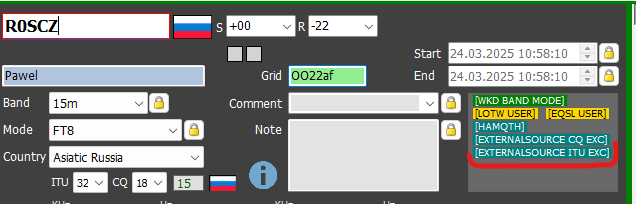

when I enter the call in Log4OM I also get the information: maybe it has something to do with the "Externalsource" messages?
When trying to upload the upload confirmations window only says "QRZCOM END" and I have no idea how to get the QSO uploaded

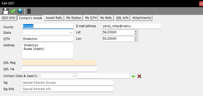

I got it working now.
The problem is that R0SCZ is not a member of QRZ.com and the data comes from hamqth.com
Under "county" a name in russian language was displayed: After removing this entry the upload to QRZ.com worked again without any problems.
73 Stefan
