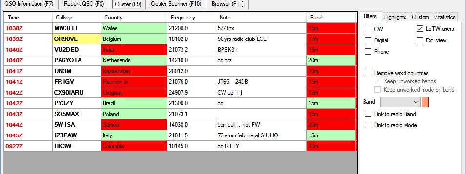

I thought that the combination of the LOTW Users selection in the 'Filters' tab when used in conjunction with the selection of 'by LOTW or QSL NOT received' in the 'Highlights' tab fulfilled this purpose? Perhaps I misunderstand your request?????pa2kw wrote:Hello,

By selecting the LOTW user in the Filters tab, I only will see LOTW users isn't it?
If so, that is not what I want. Then I will miss the ones that are not LOTW user but from whom I still need a paper QSL.

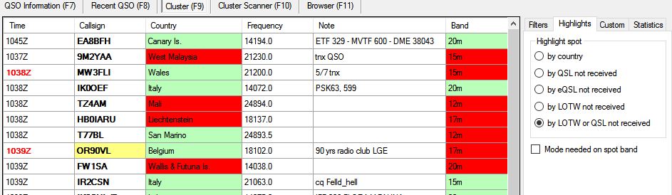

Re: Cluster Filters
Evert,
We just updated the title to NOT Received because many users did not understand the action
Have yo used the extended information facility in the cluster as below?

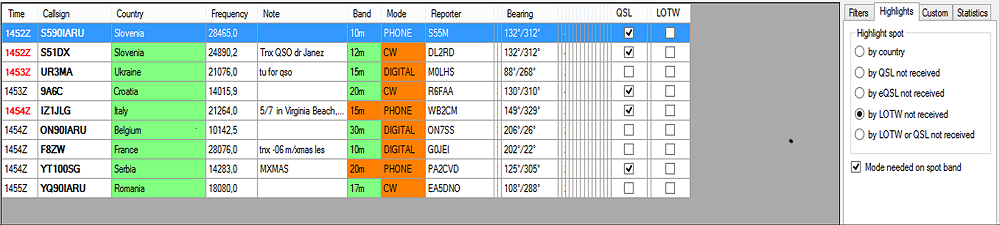

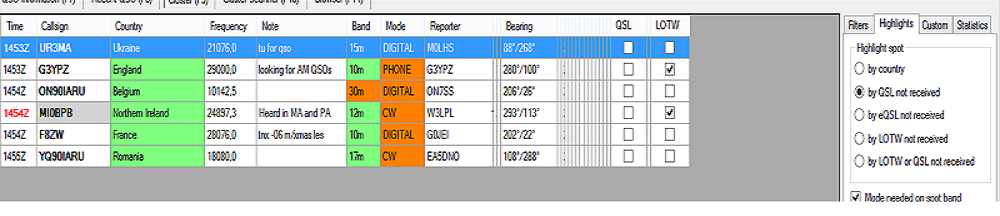

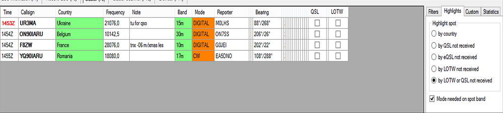

But I think something went wrong. I'll give the example from my logbook.
I started the cluster for just a few seconds and then stopped it so I could analyse it easily.
"by QSL not received" Is correct (checked all entries)
"by LOTW not received" Is correct (checked all entries)
"by QSL or LOTW not received" Huh ??
BUG : the description should be with AND : "by LOTW and QSL not received"
WISH : I'm looking desparately for the one acting with OR "by QSL or LOTW not received"
That would give me the next calls in the cluster window:
S590IARU
S51DX
UR3MA
G3YPZ
ON90IARU
9A6C
IZ1JLG
F8ZW
YT100SG
YQ90IARU
Please have a carefull look into this
Merry Xmas
73's, Evert PA2KW

Re: Cluster Filters
"I thought that the combination of the LOTW Users selection in the 'Filters' tab when used in conjunction with the selection of 'by LOTW or QSL NOT received' in the 'Highlights' tab fulfilled this purpose?"
No, I'm not looking for spots in cluster window limited to LOTW users only, but spots that went through the filters which are LOTW users highlighted/marked.
73's Evert PA2KW
