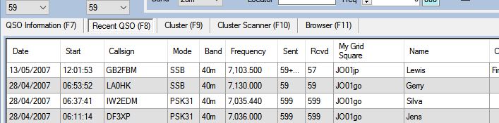

Is "my locator" stored each time when a QSO is entered and as such unique QSO-data?
Yes it is and in accordance with the ADIF specification it is called 'My Grid square'
I had 3 call signs and was active from different QTH-locators in a variety of combinations Call/Locator.
I imported my single logbook (extracted from VQLog) with all my QSO's.
Assuming VQLog conforms to normal ADIF specification and the locator Data was included in the ADIF export then the information will have been imported into Log4om
I did not find back "my locator" at the stored QSO's. I do see (in the down-left corner of the "QSO Update" window) "station call" and would have expected "my locator" there as well.
We don't actually display the locator in the QSO Update window but we could if required, it is however possible to display it in other views like Recent QSO's, QSO Information, QSO Archive etc by using the 'Layout' button at the bottom left
