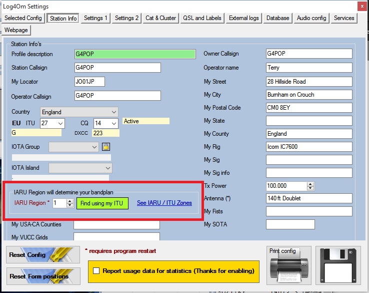

Providing you have set region 2 in the options as shown below (I am region 1 hence the setting being different) and restarted Log4Om after changing the region because the band plan is loaded at runtime it should work fine.
Has to be something you did wrong because your the only one of the thousands of North American users that has a problem!

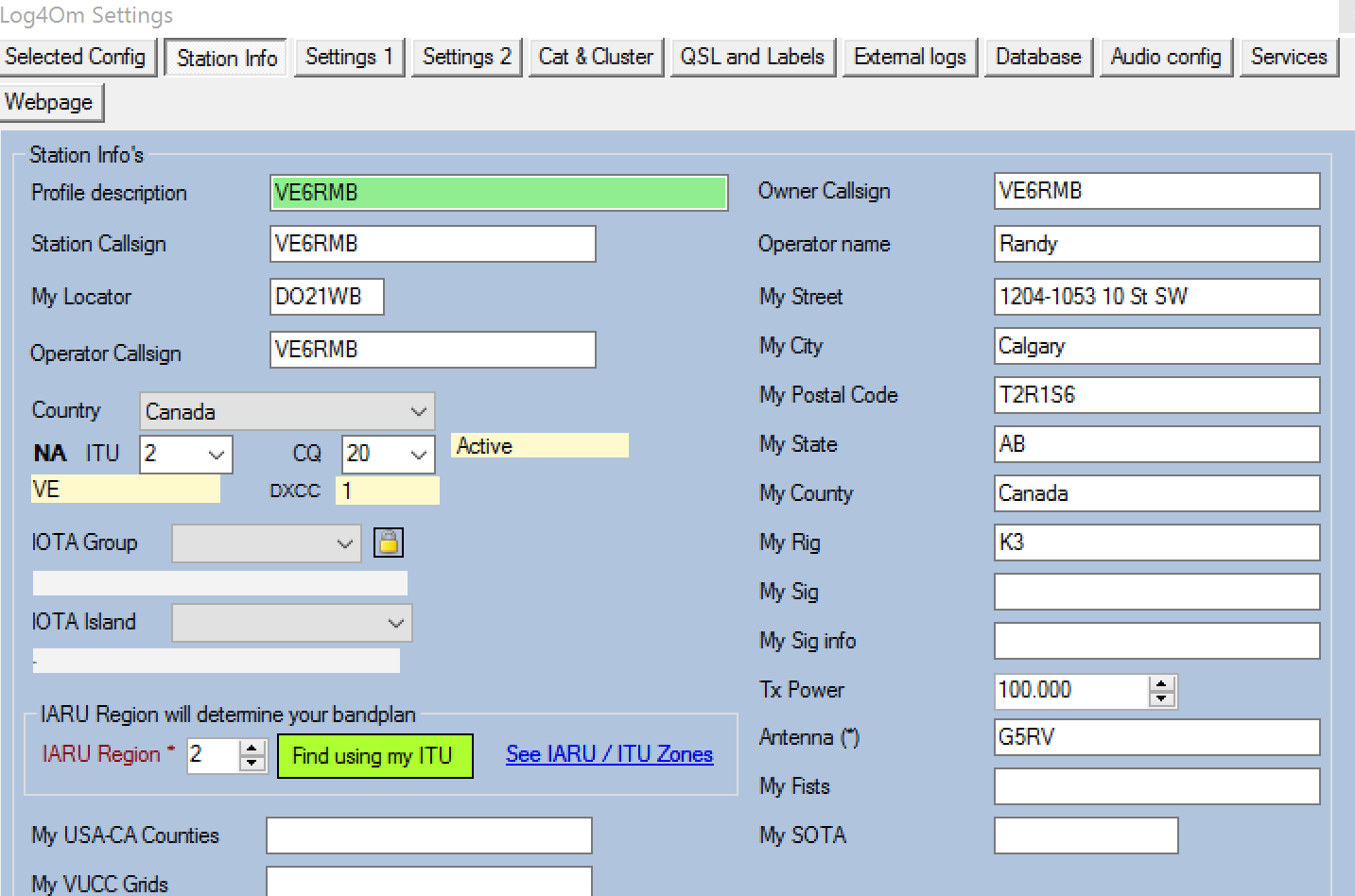

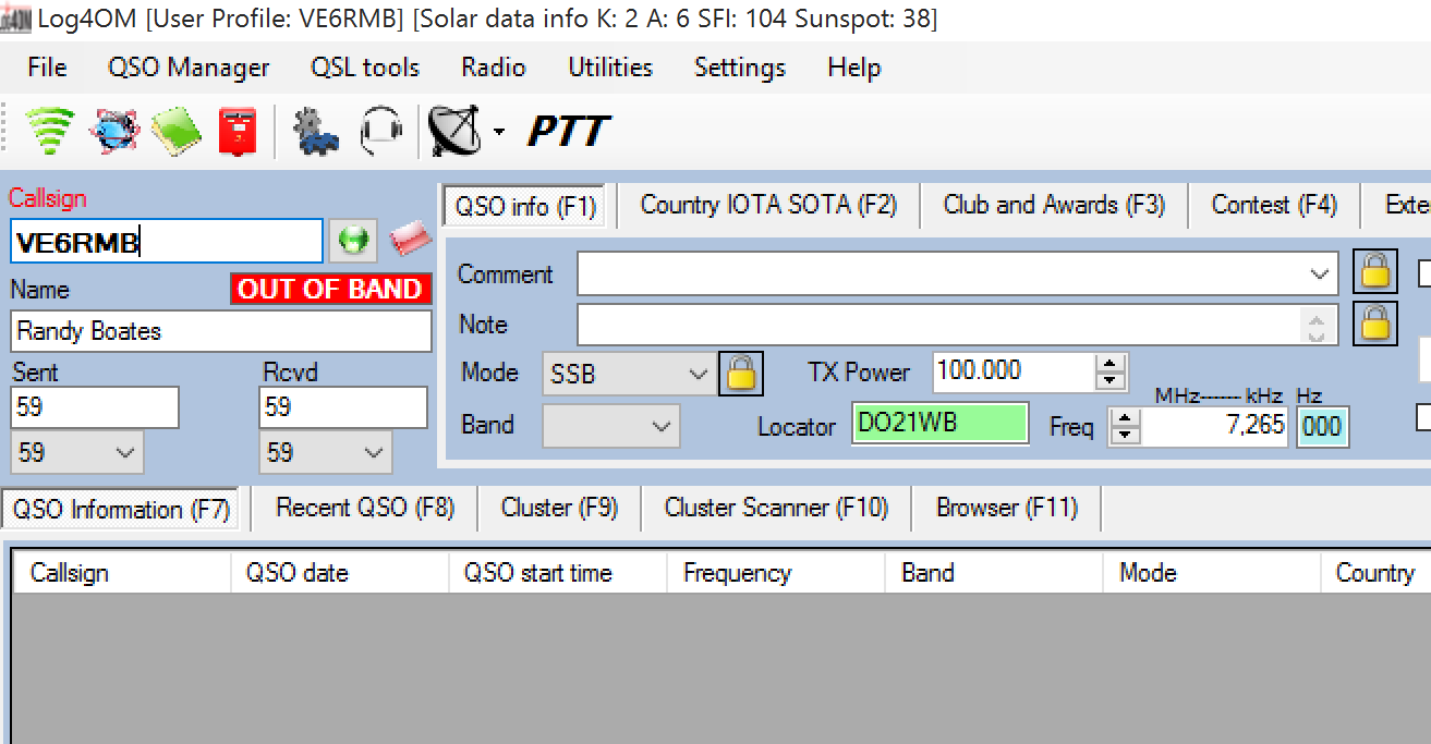

Thank you... I expect that I did something wrong - just trying to figure out what and fix it. A couple of screen shots that also might help.
Randy
Randy
- Capture1.PNG (56.18 KiB) Viewed 4535 times
- Capture.PNG (58.36 KiB) Viewed 4535 times
