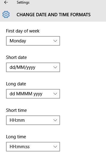

Log4OM takes the date and time format from the Windows settings - Please visit your Windows Date and time advanced setting to change this

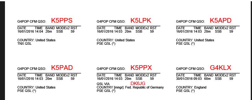

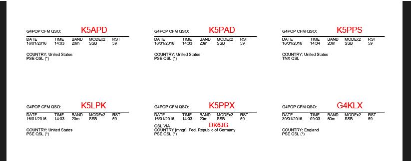

As you will see from the screen grabs below the size of font changes for me, first example is with a font size of 6 and the second one a font size of 8.
Please provide a step by step description of the method you are employing to change the label font size?
Font size 6
Font size 6
Font Size 8
Font Size 8

I have not used vista for many years but I think the available date and time formats are much the same, so see below for the formats you should set
