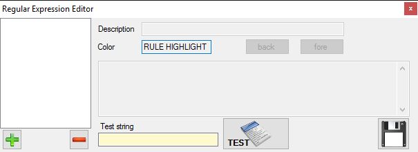

I am using V.1.24.0.0. there no award programs showing in the Regular Expression Editor. How do I add any awards and where do i find the text to fill the large box of this window for programs such as IOTA, SOTA, NPOTA, World Flora Fauna. 73 Lee - VE4DXR

having the same problem here as i have seen today. No highligts when IOTA, SOTA or other awards are spotted. I have deleted both files and restarted Log4OM but no change. No filters in the Regular Expression Editor ...

tried a new installation (the 4rth since new Beta is out) and both files are have 1 KB and the REE window is empty as you see in my attached pic in the post above ..... Tried your files from the ZIP, unpacked it and copied the files in the config folder. Both files show 3 KB. After restarting Log4OM the file "regexpfilters_Cluster_user" is back to 1 KB and the editor window is empty .... No award spots will be highlighted
