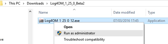

Please reinstall but select Run as administrator by right clicking on the install file

- Posts: 11593
Re: Log4OM stops after booting
The error message refers to a corrupted line in the SCL file, this would not cause the program to fail to start - Just update the SCL file in the normal way and that should cure it. If it still shows the same error after an update then delete the old SCL file and update using a fresh one.
However your install of the software is to a strange location, H:\Documents & Settings\Signalink USB\...... folder???? why did you not allow Log4OM to install to the default folder?
You are correct regarding admin privileges but of course you failed to explain that you were using XP, this is why we ask users to identify what OS and version of Log4OM they are using when the post on the forum!
