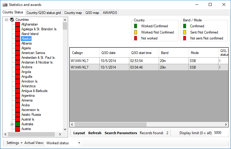

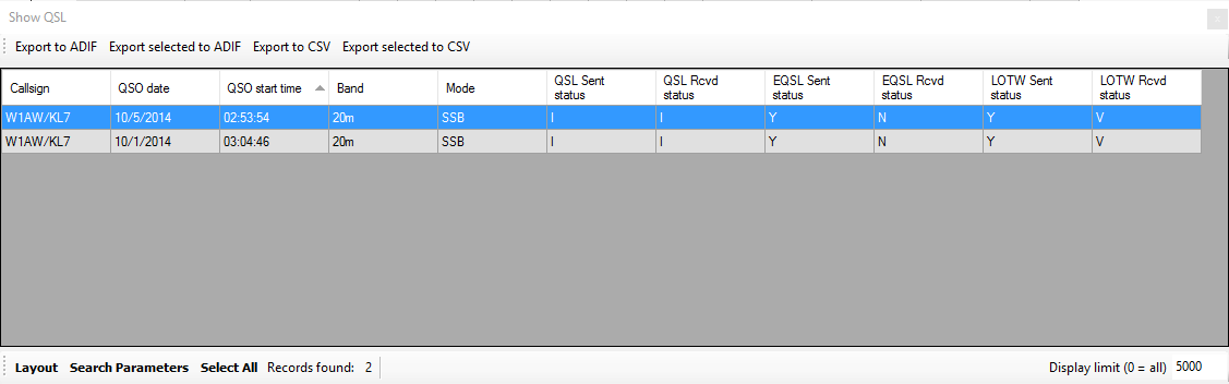

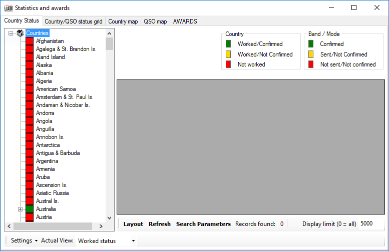

Here are the screen shots i have gathered. I have taken a shot of the screen grid for awards under dxcc. Grid is blank dxcc count is low. click on a blank on the grid IE: alaska and qso appear. it does this under other award headings..
alaska stat.PNG (32.1 KiB) Viewed 6159 times

Notice the countries are also in red when they have qso's...
dxcc stats.PNG (69.87 KiB) Viewed 6158 times
