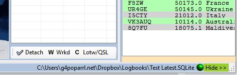

The database will be named by whatever name you decided on when you first used Log4om and it is displayed at the bottom right of the program window as below.
In this case the logbook database is named Test Latest.sqlite

4.. Find the SQLite file which is the one shown at the bottom right hand corner of the Log4OM window as shown in my last post and copy it to the C:\.................\Dropbox\Log4om folder you just created - Allow some time for the file to synchronise on both computers!
5. On each computer go to File\Open database and select the SQLite file that you just copied to the C:\.................\Dropbox\Log4om folder - You are now able to use either computer for logging and both computers will have the logbook synchronised via Dropbox

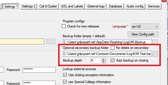

6. Now go to the Log4OM Options\settings 1 tab and in the 'Optional Secondary Backup folder' field navigate to the C:\.................\Dropbox\Log4om\backups folder you created earlier
7. Check the boxes 'No delete on secondary' and 'Auto backup on close'
This ensures that you have a backup on both computers in the default location and another (Secondary) backup on Dropbox
